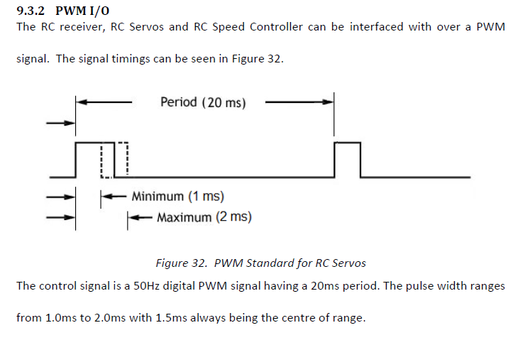

Assuming your talking about an RC servo, you could use the onboard counter of the myDAQ to generate a pulse train.  The code for that is explained here.
RC Servos work as follows:
Knowing this information and using the code in the link you can control an RC servo using the myDAQ.  The counter output is on DIO pin 3.  The attached code worked for me with my own myDAQ.
