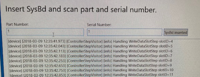

I have one 3rd party exe file. i want to write data on UI and controls button of 3rd party exe(user interface) using LabVIEW.
In that exe i want to write serial no and part no. After writ
ing data i have to press one control button in same exe.
So please guide me how can i write data and press control button on that exe. using LabVIEW.
for reference i attached image of 3rd party exe(UI)

With the help of SysExec function i am able to call the exe. but i don't know to write serial number and part number on that exe using labview.
