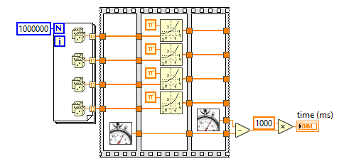

I assumed that code sections without data dependencies between each other always execute as different threads in order to benefit as much as possible from multicore CPUs. This is apparently not the case. It is true that these sections execute "in parallel" but only in the sense that it's not possible to predict which section would win a race condition - they could be still executed sequentially in a single thread (albeit in a "random" sequence). Here is an example of a simple benchmark:

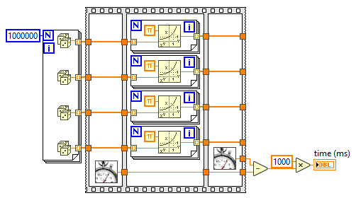

The exponentiation of a large array is computationally demanding, so I would expect Labview to use 4 threads, but the execution of this code takes exactly 4 times as long as the execution of only one instance of the exponentiation function. I tested it on a quad-core CPU, of course, and the CPU usage in the task manager also showed just one core being used. Now let's test the same example but use explicit for-loops instead:
This time it's actually multi-threaded and the execution time is almost as low as for a single exponentiation instance on a quad-core CPU (and the task manager shows a higher CPU load, accordingly).
