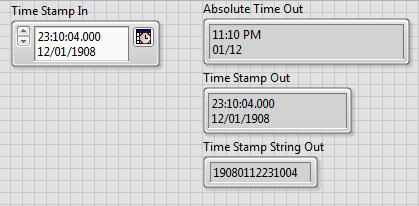

I have set the display format of the numeric control to Absolute Time format. Then I would like convert the time into string and then write into a table control.

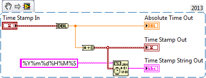

Have a look at the To Timestamp function:
https://www.ni.com/docs/en-US/bundle/labview-api-ref/page/functions/to-time-stamp.html
You can then use Format Date/Time String to format to your heart's content.

The Format Into String could also be a good use here.  Just set the format to be the same as you have for the numeric indicator.
