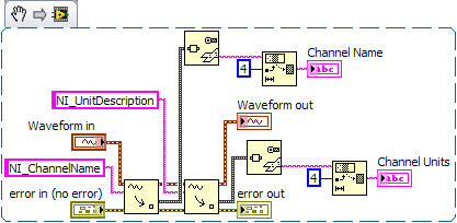

Your question asks for a 1D arry of Waveform attributes, but your picture shows that you want a 1D array of attributes from a 1D array of Waveforms (where each element  contains all of the attributes of the corresponding Waveform).  I'm going to assume the latter.
I'm typically interested in Channel Names and Units from these attributes.  So to add to Viru's post, this may also be useful for you:
