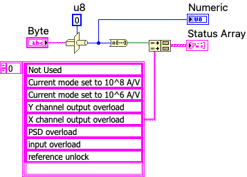

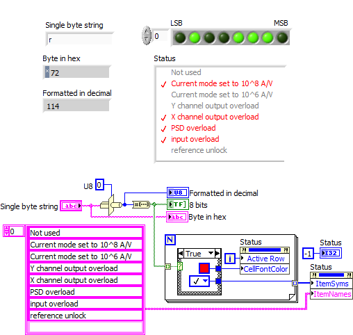

One possible alternative for display would be a listbox. Now it would be much easier to e.g. change the language.

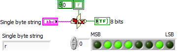

You can use 4.x mode typecast to convert the string directly into a boolean array, but be aware that the MSB is now element zero.

OK.  How's this:

Of course it could be put in the legend or some free text. Here's how the legend could look like 😮
