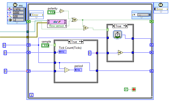

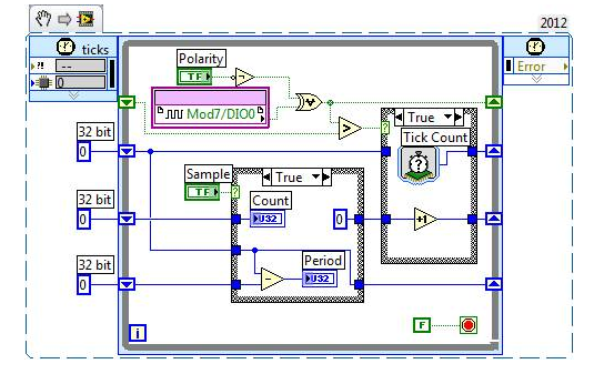

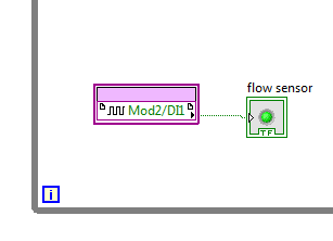

Below is what i've done but the count or period doesn't give any value.
fpga flow.PNG      <<<<<<----- fpga for flow sensor
host flow.PNG<<<<---- Main host for flow sensor
