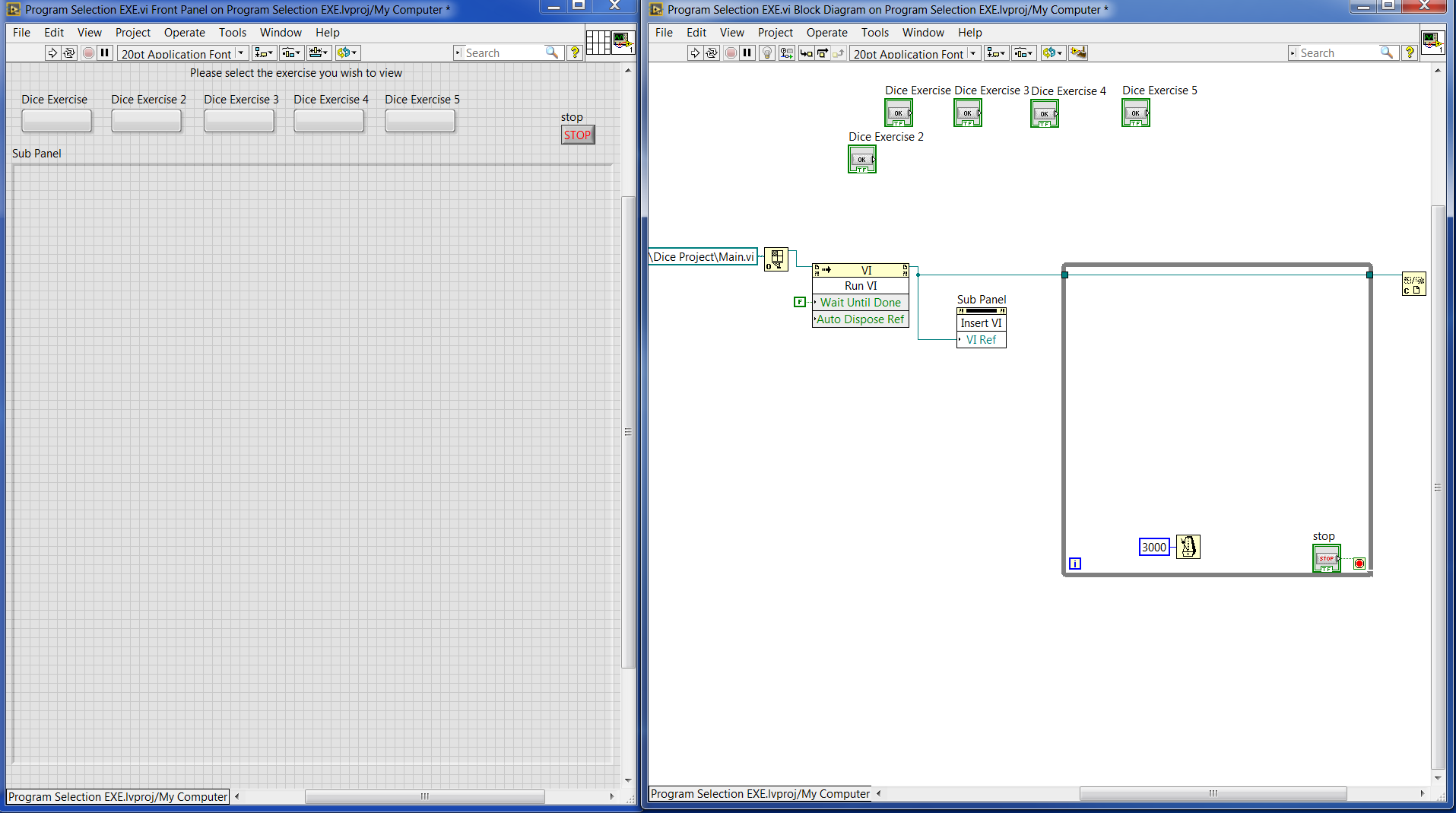

Hi everyone, thanks for the suggestions and advice.
I will give it a go with all three methods as a learning exercise.
I'll start with the subpanel since that seems the most prefferred method.
So far, I have used the NI tutorial to successfully port one VI into the sub panel.
So now I need to figure out how to get push buttons to control which VI is loaded into the subpanel.
I was thinking of using case structures for that.
I wanted to use push buttons, so wondered if there was a way to alter a case structure based on which push button was pressed? I've attached an image of my set-up. The 5 bolean push buittons I need to somehow connect to a case structure that can determine which button has been pressed. Any suggestions?
When another project is referenced for a sub-panel, will that other project be included when a zip file or EXE or installer is produced?
I have also attached my code as a zip file.
Message 7 of 19
(5,305 Views)

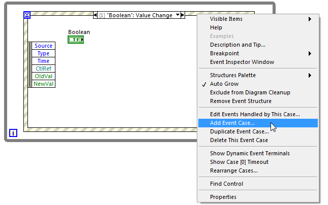

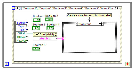

Here are your two options... (and also how to add event cases)
One case for each button:
One case for all buttons, and how to tell which button was pressed:
I suggest you have a look at some of the Event examples or see if you can find some tutorials on the event structure!
