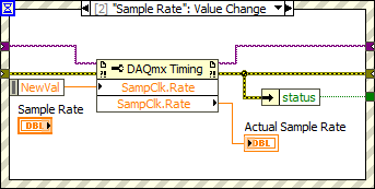

FWIW, I recall that commonplace MIO boards such as your M-series can *also* allow you to change the AO sample rate on the fly as another method for changing the output waveform's frequency.   You would use a DAQmx Timing property node to set SampleClock.Rate.   (Mod below added to shipping example and tested on a simulated device).
-Kevin P
