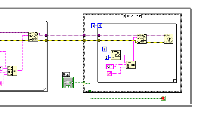

One final question regarding stopping all the pumps. When i run it in highlight execution mode all the pumps get the command and stop. BUt when i run it normally only the firt pump stops. So i put in a 10s time delay between the program stop and the case structure to give it enough time to send all the commands but that wasnt enough. how can 10sec not be enough? when it updates the rates instantly when i change the dial...

The for loop with the VISA writes which Cory posted has a VISA Close inside the loop.  It closes the VISA session on the first iteration.  Thus, the VISA reference will be invalid on the second and third iterations and no writes will occur.  Move the VISA close to outside the loop.
