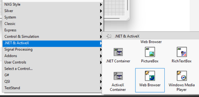

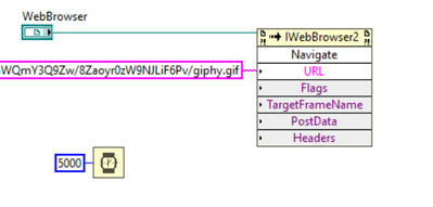

To show it, the easiest would be a Web browser container.
Then just load the image in the block diagram

Thank you so much. Sure, I will try to use this method too
