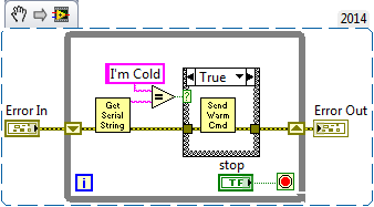

Hello, Pavel.  You can simply compare the Serial String to the string "I'm Cold", something like the following:
I've "hidden the details" of how to get a Serial String (actually, that's an empty sub-VI, but it certainly could be "the real thing") and how to Send a Warm Command inside two sub-VIs.  Notice that, by doing this, I make the logic of what's happening here much clearer than if there were lots of wires, lots of VISA functions, cluttering up the Block Diagram.  Also, if these were "real" sub-VIs, I could run them in isolation to specifically test that the code works.  And it makes such a neater, smaller Block Diagram ... [I'm something of a nut on sub-VIs, if you couldn't tell ...].
The "equality" comparison works if you know the exact string that you need.  If you worry about matching string case (i.e. allowing "I'm cold" or "I'm Cold"), you can use the "To Lower Case" function on the strings before the equality.  There are also String Functions (on the String Palette) that will let you do more sophisicated searches, should the need arise.
