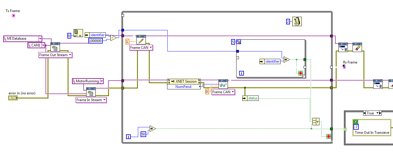

How to deal with XNET Write and Read in one loop?
Also if you add a delay between write and read?
(It is not the timeout value im talking about, just a normal Wait(ms))

OK this is an old post but I was just reviewing the NI-XNET Hardware and Software Manual and looking at some exemples and I got back here.
Since you are writing and reading from the same interface you need to set the XNET Session Interface: Echo Transmit? property to TRUE.

How did you solve this issue? I am currently trying to write and read from 2 separately running vi's but I always get 0 frames read back on the first read if i leave frames to read as -1 and timeout to 0.
but if I add a timeout and tell it how many frames to read I always get the requested frames back. This is very weird behavior.
Does the session need time to start. i.e do we need to add a delay after starting the session?
