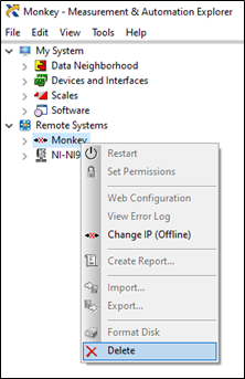

I know how to do it manually...

It's not totally programmatic but you can right-click on Remote Systems and remove all disconnected systems which at least saves you from having to delete each one individually.

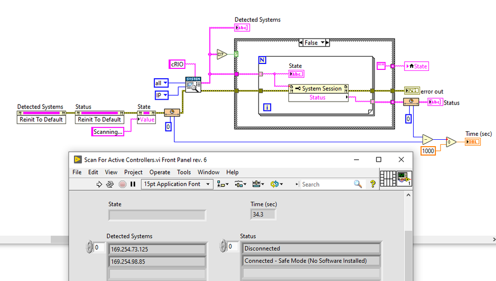

Finding the disconnected systems is relatively easy and slow as molasses.

Looking at the full Help for Find Systems, it looks like if you set "Detect Online Systems" to False it will only return previously discovered systems. That sounds like it'll be pretty quick.
