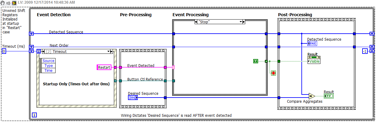

Here's a code snippet that you can drag and drop to a LV 2009 block diagram.
Kurt

Hey Kurt
I will try to incorporate your code into my vi.
I will go with the first vi you attached earlier.
Get rid of the while loop
Thanks for the help.
I will post the final product when done.

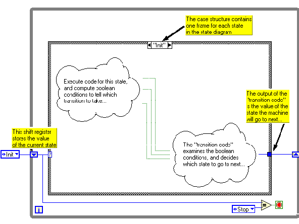

Start by reading this: Application Design Patterns: State Machines.  If you look in the project templates, there should be a simple state machine to give you a start.  State Machines can be really simple and are very powerful.

I get it.
So my states:
  • Initialize transition black to....
  • Red/Process button sequence
  • Blue/Process button sequence
  • Yellow/ Process button sequence
  • Random/Process button sequence
  • Interupt Process button sequence if error
  • Display pop-up/write to file for successful trial
  • Display pop-up/write to file for unseccussful trial
  • Reset or Stop
All can be done using this architecture?
It would be easier now that i know what to do with the coding
Thanks!
Message 17 of 18
(1,309 Views)
Yes. You can use those states to do everything you need to. If you need more states, that's fine. You can have an infinate number of them. Think of a flowchart when you design it.
I would strongly suggest using a 'Wait on Event" state and place a Event Structure within that state so your not pooling and using up CPU resources. Look them up. Another powerful tool you can use with the State Machine.
