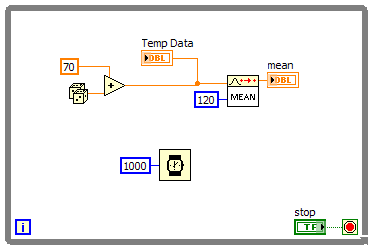

You can do point byExample_BD.png point averaging. See the example below
Tim
GHSP

I might have read the original post wrong but I thought the objective was to track the max temp not the mean temp?
Like this: -
David
www.controlsoftwaresolutions.com
