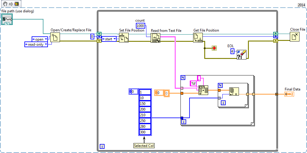

As others told,
If you have problem with Data size to display all data at once then Read chunks and Build your array.
Check this snippet,
Here, I’m reading every 1000 lines from file and picking selected index (column) & Building the array.
Munna

@Dennis: I was working on Munna's previous suggestion before I saw his updated suggestion.  I'm trying to understand how the blue array works.  I can't figure out what the 0 on the left represents and why there are 4 elements but there's a number 2 in the second box.  Are we choosing the second column?  If so, why put the number 2 in the second box?  Why not put it in the first or third or fourth?  In the index array, where's the row index and the column index?  I looked at help and it said to specify the row and colum index but I can't even figure out where they are.  I'm getting extremely frustrated!!
There's nothing particular about choosing which column will be used; it depends on the engineers and what they want to see.

If you’re getting frustrated then who will do you task?
Index array will works based on your input array. If your giving 1D type array then you can select only Row index. If it is 2D then you can select row or column or both (depends on your requirement).
Check this attached VI. I made 2 approaches. one is to read all data at once and other one is to read by chunks.
Based on your Data size, use which one you wants.
At first it will display all your signal list, from that you need to select signals to display.
Munna
