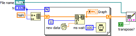

No, 100ms is a very, very long time for a computer, sufficient to do almost anything. It also means that your recording is many second, so you might want to update the graph as it is acquired. Also 10000 is quite small.
From a memory handling standpoint, I would recommend to allocate the final size in a shift register with NaN, then replace with real data as it arrives. After the loop, you can save the data. (NaN will not show on a graph)
Here's how that could look like. At the end it saves it as one column.
(Notice that I am kind enough to show you the full code picture.)

Thank you for your advice and code!
I will try to write a VI myself and go test it.
