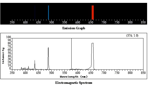

I want to display a line spectrum in color band format.  What I have are two arrays: wavelength and intensity. I can plot the graph like the bottom one and I want to convert it to the top color band. The considerations are:
1. the color must agree with the wavelength.  For instant, the 650 nm corresponds to the red color and the 490 matches the blue
2. the line intensity is indicated by the line width of the color line.  For instant, the 650 nm line is a strong one and its red line in the color band is the widest.   The 435 nm line is a weak one so it is barely see (but still visible) in the color band.
I would like to know if labview has any built-in function to assist me with this job.  If not, any idea of implementing this?
Thanks in advance for any suggesting.

i dont think there's labview support on this...the easiest way would be to code it yourself, by drawing an image and using rectangles...to color-code your rectangles, you will have to specify some sampling points (400nm-->blue, 540nm-->green...) and to interpolate between them...the more sampling points you have, as better the color matching...

You can use the Picture functions. I would start with the shiped example .....\examples\picture\demos.llb\Histogram Plot.vi and modify it to fit your needs.

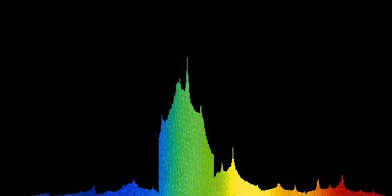

You mean like this?

yeah, thats what i meant :-)...didn't know that theres already an example...

YES Intaris, your bottom plot is very close to what I need.

Can you give me hints on how to make your bottom plot?

I used a picture control to generate the images.
An important note is to ALWAYS create the picture from scratch (start with an empty picture) because if you keep drawing over the old one, performance gets really bad really quickly.
I'll post an example when I get back home, that's where my code is.
