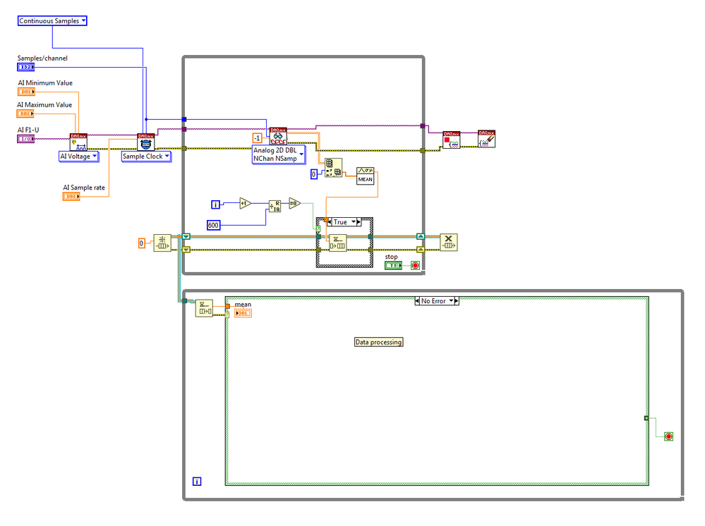

Hi Bob,
This is currently part of the code I am working on. I hope I could find a better way to make the block average. the current method I am using is time-consuming.

Your code is very different than what you described. You are not averaging 600 data points. You are taking the average of 1000 data points every 600th reading. Did you even try the code that crossrulz suggested?
Message 7 of 10
(5,642 Views)
No.  He's taking the average of how many data points happened to have been acquired since the last loop iteration.  Then sending that average to the other loop every 600 loop iterations which may or may not represent 600 data points.  It is almost certainly not the average of 600 points or 1000 points.
I made the assumption that he was setting Samples/channel to 1000. He's telling the DAQ to wait forever until there are Samples/channel data points and then read those Samples/channel data points, then averaging those data points and sending every 600th average to the other loop.
