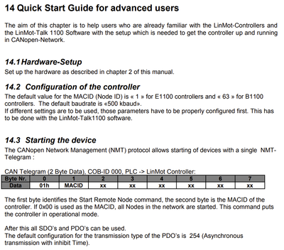

I want to control linmot with Canopen interface. In my case I use a E1200 drive from www.linmot.com  . So I use labview to communicate with E1200 with canbus. Now I can receive data from E1200 drive, but when I send command data like (homing: 00 00 00 00 00 00 08 3F) in 8 bytes to drive with PDO 1 (it's 201h because I set the node id to 1), there is no reaction from drive. Is there any other things I need to do? I'm referring to page 44 of the attached manual.

By the way, I found this before, and did what they said(sent 01 01 to COB ID=000h), finally I could see the controller is in operational mode through software. But there was still no respond when I sent homing comman.
