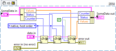

I have tried your suggestion rolfk and it works.  Some code is attached below.  The next issue is handing data that contains a mix of values and arrays.  I could configure my device to transmit the array sizes before the arrays.  That way I could receive the size, flatten it, append it onto the front of the array, and then unflatten the array with the appended size flag turned on.  I will probably experiment with this later.
tcp_client_some_data.pngtcp_client_some_data.pngUnflattenSomeData.viUnflattenSomeData.vi
EDIT:  @crossrulz - I did see your post.  I used your post and rolfk's post to develop the above.

And now you could define a cluster in LabVIEW that contains two int32 in the beginning and then an actual single precision array and wire this directly to a single Unflatten function, since you added the additional int32 length value that LabVIEW expects to find in the data stream when unflattening arrays inside a cluster.
