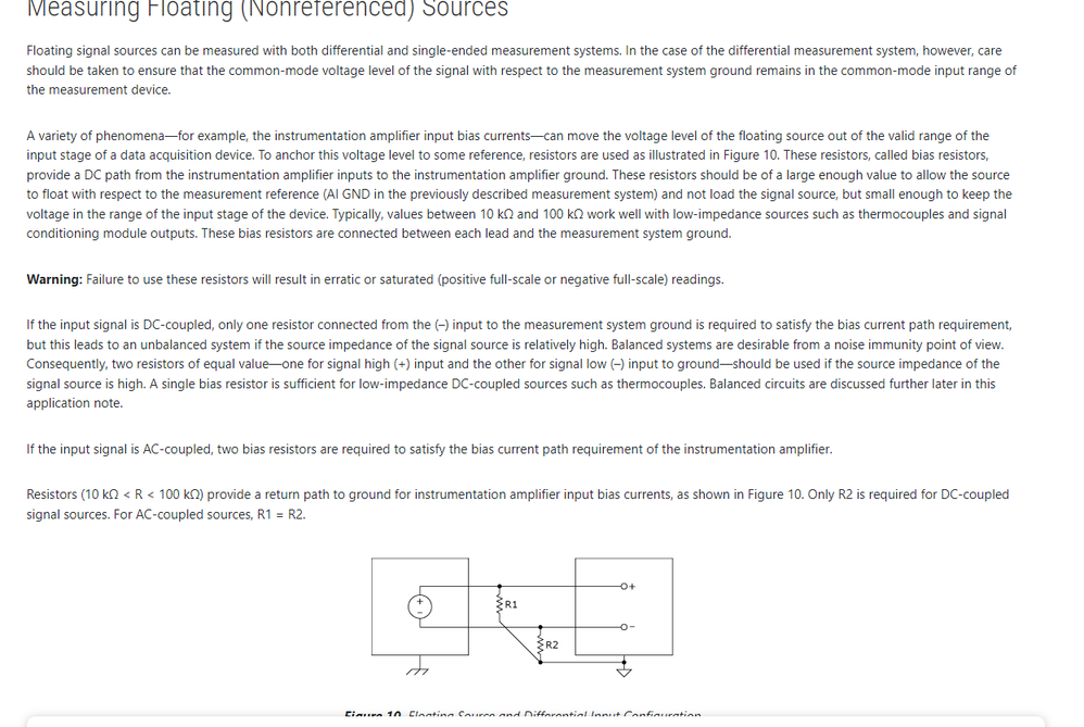

I would check your wiring.
See this document
https://www.ni.com/en/shop/data-acquisition/measurement-fundamentals/field-wiring-and-noise-consider...
Dan Shangraw, P.E.
