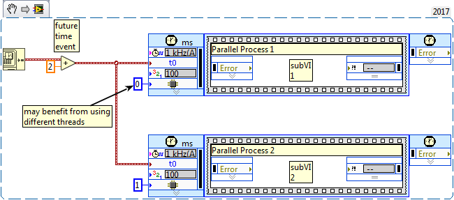

Here are some suggestions in addition to the attached snippet:
-set identical absolute time for timed structure to start (future time event)
-assigned different processors to each task
-identical timed structure priority setting
-set "call library function" to "run in any thread"
-may get benefit from setting subVI 1 and 2 execution priority to high or time critical
