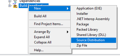

I've never used this, but you can make a build specification of the type "source distribution":
You should be able to select what gets copied to the distribution.
You should also be able to select items that get password protected, or that get the BD removed (the FP can also be removed).
That's potentially a lot of maintenance, but it seems like the intended purpose of a source distribution build specification.

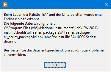

The craziest thing that the LVLIBP becomes part of the project. As soon as you open the project next time, LV comes up with a circle error caused by the same MNU file allegedly loaded multiple times, showing you the paths of the MNUs to be in the subfolder structure of the LVLIBP. But if you open the tree view of the lib, there are no MNUs in the subfolders. There is only one MNU in the main folder. OK, something went wrong, so start again.

It doesn't work for me. I have LV 2021. I create a blank new project. I add the folder structure that contains the VIs. I right-click "Build specifications" to either create the source distribution or the packed library and LV simply does nothing. Restart LV, no chance. Like the app builder is dead.
Message 16 of 42
(1,572 Views)

Futher tips and help wanted. What I did:
  • Created a new project
  • Added files/folder, including dir.mnu
  • Turned that file/folder structure into an LVLIB -> the structure shown in the project tree view is fine, all folder names correct
  • Created a build specifiction for "Packed library", set the LVLIB as main lib and the dir.mnu as palette file
  • Compiled the LVLIBP. After saving and closing the project, LV comes up with palette loading error (circulation) and shows me the paths in the LVLIBP to allegedly have all the same dir.mnu file -> if I open the LVLIBP it shows just fine in the tree view. Just one dir.mnu, all folder names OK

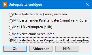

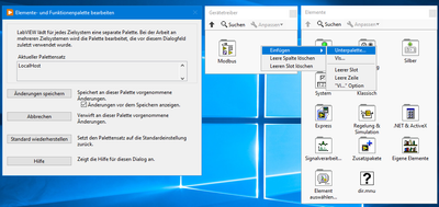

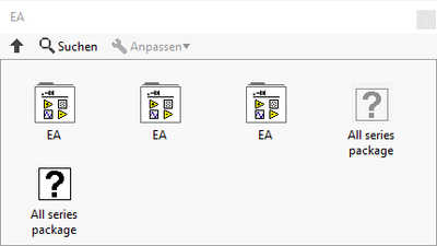

  • I then open a blank VI and go to palette editor. In the editor I create a new subpalette and link it to the dir.mnu in the LVLIBP -> the result is that subfolder names in the context menu are messed up
How to solve that? My best guess is to actually create MNU files for every subfolder, but with different name, as suggest here.
Message 19 of 42
(1,544 Views)
