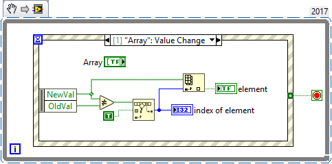

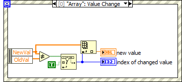

There is an event data node for "new val" and "old val" Compare them with != (not equal) and use "search array" for the value TRUE. Use the returned index go index into the "New val" array to get the new value.

Accepted by topic author Gaffinator
This should work. It returns -1 if you create a new value though (i.e increase the size of the array)
changedValue.png\
Edited to add the value via indexing, but I saw my Lack of LabVIEW Programming Speed was Disturbing...

But yes, as cbutcher said, you need to possibly add code to detect size changes.
Also be aware that e.g. using "val(sgnl)" you can create situations where either all array values remain the same (found index = -1) or more than one (or even all!) changed at the same (more than one TRUE to find). The current code only gives you the changed element with the smallest index. IF this is of concern, you need to add more code to detect and handle all the possible scenarios.
If the array is a more advanced datatype (e.g. an array of a complicated cluster), you might need to dig a little deeper, of course.
