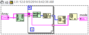

This is how i did it using some OpenG array functions, like Remove Duplicates and Filter Array.

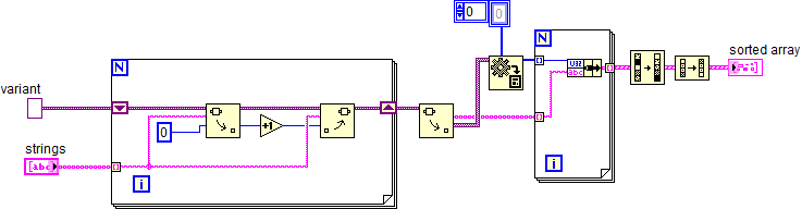

Since the question was: "I have this array of strings and I want to find the most frequent entry of that array", here's is a more tailored solution to the actual question.
Still, my more traditional approach outlined in the first answer would probably be more efficient, because it does not generate any large data structures. Try it!

Here's what I had in mind. Does not need any array allocations (LabVIEW 2013).
(Probably needs a few tweaks if you allow nonprintable inputs)
The second VI also generates the sorted output like the variant version.
