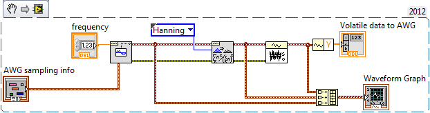

use this 5 min  vi .....
and help yourself by loading the instrument driver (Help-Find instrument driver ....)
