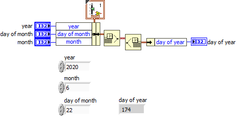

How old is that code? The format of the "date time rec" cluster has changed decades ago, so I recommend to use the current version.
See if this works for you:
(I am not sure why you have a while loop without any wait. I doublet it is necessary to recalculate the same input millions of times per second)
(3,490 Views)
Thank you for your help. the code is exactly what I need!

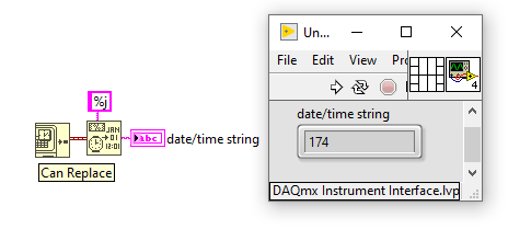

That code could be reduced to the size of a couple of postage stamps. Somebody wise once said, do more with less. All you need is the %j specifier.
mcduff
(3,459 Views)

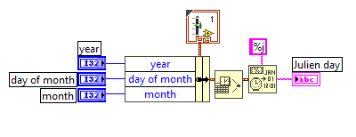

@mcduff wrote:
How do you enter an arbitrary day/month/year into the three given controls??
(e.g. for 07/01/2020  = 183)
(3,449 Views)
I did not enter anything into the controls. It can be done like below, just use %j for Julian Day; this is pretty close to the OP's original request, a string result.
mcduff
PS Sorry, didn't mean to insult, just some playful teasing.
(3,442 Views)
Oh, no insult felt here 🙂 Always enjoy creative wording. 🙂
I would argue that unbundling "day of year" is easier to read for most. Code size is similar. It also depends if we want a numeric or string.
