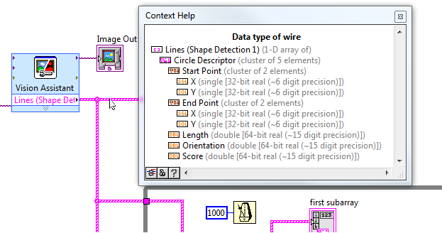

Hello hzub1,
It seems your having trouble getting to the information in the output of your Vision Assistant. You can use Context Help (Ctrl+H to show) to help understand the contents of a large array or cluster when you hover your mouse over the wire (see below).

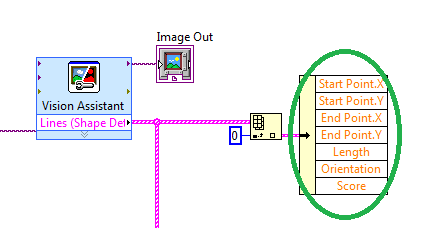

Looking at the above I created the code below which breaks out all the contents of one item in the array.
Here I use the Index Array function to break out one element of the array. Each element is a circle descriptor, cluster of 5 elements so I use the Unbundle by Name function to access each of the values in the cluster
I hope this helps,
Jack. W
