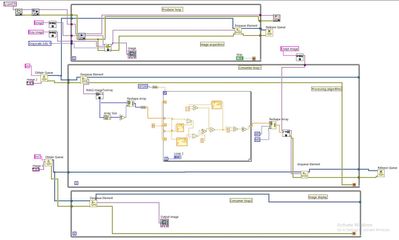

Hello Bob-schor,
Thank you for your suggestions.
I followed your suggestion that the separate loop for "Acquire image," "Process," and "Display image" using the producer/consumer loop. Still, the same delay is occurring in an output image. Please look into an attached VI program and let me know if any wrong thing in the program.
Thanks and regards
Sukumar
Message 13 of 16
(1,108 Views)
If the displaying is really the bottleneck, why would you display all images?
Why not update just the most recent image?
This can be achieved by simply using a 1 element queue and a lossy enqueue for the 2nd to 3rd step.
The for loop to process the images has redundant stuff in it. Why multiply with 1 (2 times)? Why multiply with -1 and than add (that is a subtract).
The Image To Array, reshape to 1D, reshape to 2D and Array To image are probably expensive.
Of course your wires are so twisted and bended, the code will execute slower.
Spoiler
It won't, but it will stop you from seeing other problems.
Message 14 of 16
(1,104 Views)
And by multiplying with 1, you also convert a lot of the data in the for loop to doubles (note the coercion dot). That's even more expensive than just using doubles... Change the constant 1 to a single to fix that.
Updating an indicator in a loop will slow it down quite a bit as well. Remove Loop 2 if you want speed.
The for loop seems to perform a simple kernel operation. Probably a Sobel or Canny will do something very similar, but a gazillion times faster (eliminating the conversion as well).
Perhaps you can explain a bit why you do the home made filtering?
@Why not update just the most recent image?
We need to display all the images, and In further steps, this continuous mage information is helpful for the continuous monitoring (tracking) of things. In the future, we would like to do continuous monitoring.
@Why multiply with 1 (2 times)? Why multiply with -1 and than add (that is a subtract).
In my original algorithm, multiply with 2 (2 times) is there, I have not included my total algorithm here, and it has two more delay block elements in the feedback path and one more delay block element in a forward way. My intention behind the posting of an example algorithm mainly to know, how to reduce the delay
@ And by multiplying with 1, you also convert a lot of the data in the for loop to doubles (note the coercion dot). That's even more expensive than just using doubles... Change the constant 1 to a single to fix that.
I will adjust it to the SGL format.
@The for loop seems to perform a simple kernel operation. Probably a Sobel or Canny will do something very similar, but a gazillion times faster (eliminating the conversion as well).
Yes, for loop is doing the kernel operation to find the edges in an image. We are focusing on developing an edge filter.
@Updating an indicator in a loop will slow it down quite a bit as well. Remove Loop 2 if you want speed
I will work it now and let you know.
@Perhaps you can explain a bit why you do the homemade filtering?
We are going to develop an edge detection (edge detection filter) algorithm, it will be helpful, whereas other edge detection algorithm response is not up to the mark.
Any suggestions would be great
