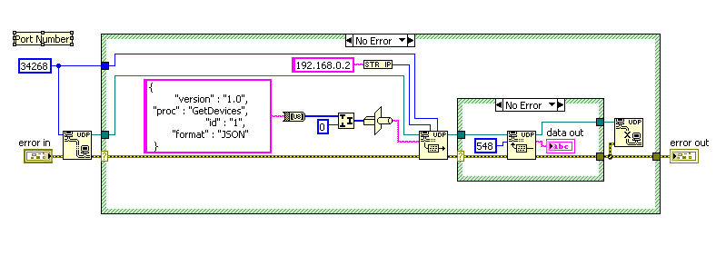

I got a response from Vincezo: http://forums.ni.com/t5/LabVIEW/Sunny-Island/m-p/1794786. I'm currently working with the VI to communicate with the webbox through UDP. Since the PRC protocols to communicate with the webbox are in JavaScript Object Notation (JSON), I'm not sure if the data-in string has to be in JSON format. However, the only error I'm getting is 56 in the UDP read function. I've tried increasing the size of the bytes and timeout, but I keep getting this error. If anyone can help me with this part I would very grateful.

Sure,
I updates the VI, now the read appears to be printing whatever I write in the Write function instead of giving me the responses of the JSON requests.

Hi Jose,
Have you tried this out? are you having comm problems? If you have decided to go through the UDP route, here is a good UDP example http://zone.ni.com/devzone/cda/tut/p/id/4950
If you have problems communicating, you can always try it locally first and then expand to the server.

(9,465 Views)
I've tried the example from http://zone.ni.com/devzone/cda/tut/p/id/4950, but I don't get any responces. I'm not sure if it's a comm problem or something else.

Hi Jose,
is your server and applications currently on your local development machine? try getting them to talk on the same machine to rule out that it is a comm issue.
