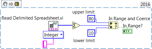

This is very simple task to be done in LabVIEW.
The first VI reads a file with comma separated values, then takes the first row and add all elements. The result is checked to be in range of 10 and 80 including the limits.
This code is enclosed in the post and was developed using LabVIEW 2016.

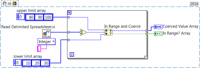

Thanks correa. Yes that helps me lot to get basic idea how to do this.
But main question is, similar to below example i have many many lines of data and different reference values for different conditions.
so how can i read data as array/table and then do some calculations and then compare with a reference values.
what approach i should use if i have data of 1000 lines and each line i have to add seperately and compare with 5 different references at different conditions.?
ex: 1,2,5,6  add all, then check is this in the range of 10 to 100
1,2,4,8  add all, then check is this in the range of 10 to 50
1,2,5,5  add all, then check is this in the range of 50 to 100
similar way what if i have 100 lines?

Hi sacsk,
Whenever you need to do a task several times you should use a loop to repeat that task!
This applies to all programming languages, not just LabVIEW…
LabVIEW also assists you as it allows autoindexing in loops: this way you can easily iterate over all rows in a 2D array and additionally over all elements of a second array holding your conditions!

Hello sacsk,
As mentioned by GerdW, you should have repeated tasks in a loop.
I have updated the code to match what you are asking for.
Just bare in mind that if your file has 100 lines, the upper and lower arrays must have the same size becaus the are being indexed as input in the for loop. You may change the code to check for every line if the result belongs to a given range.
I would suggest for you to look for some tutorials about LabVIEW online.
