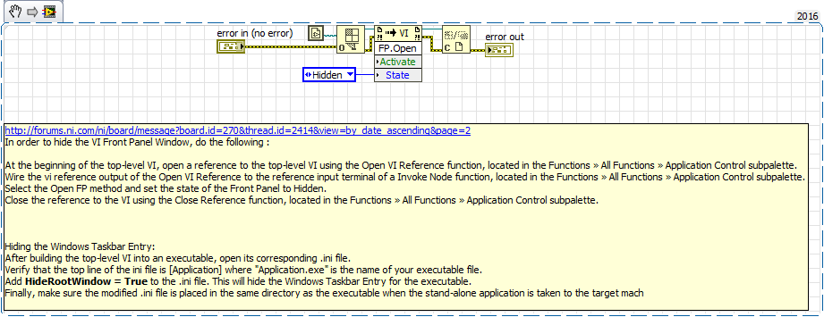

Try this:
=== Engineer Ambiguously ===

Accepted by topic author azadplc007
Did you do both (hide the vi and also use the *.ini command)?
I fiddled around with the example here and got it to work (see attached).
However, when I put the exe in the startup folder with the ini file, they both ran at startup (the ini was automatically opened with notepad). Not sure how to get around that.

Dear Dave_St,
                      This is what I expected. Thank you for your valuable help.
