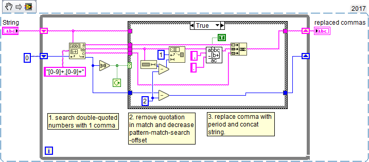

So I try to fry this little fish...
Greets, Dave
