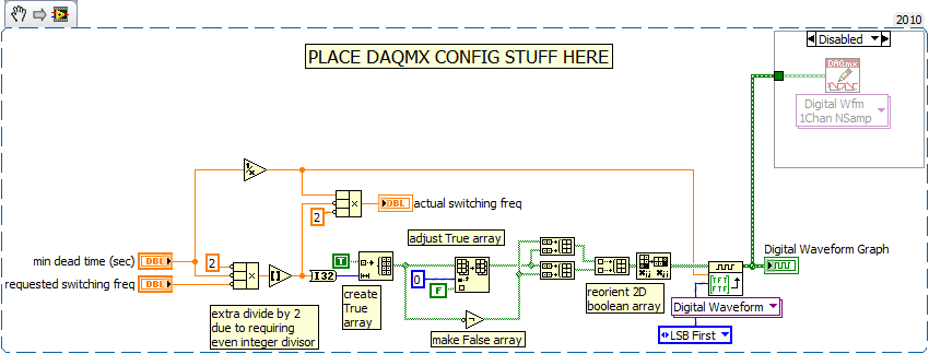

I had to do something like this before for a 3-phase motor controller where each leg had to be sequenced between low-side and high-side connections with a short dead time in between.  Can't recall now why I didn't do it with counters -- maybe had something to do with needing to support direction-reversal and variable speed?  Or maybe I didn't have enough available on the platform at the time.
ANYway, it sounds like your app is pretty similar to any 1 leg of the motor controller I worked on.  Here's a pretty simple way to approach it at first, and you can always tweak it if it's not quite what you need.
I'd plan to set up a output sample clock whose period matches the minimum dead time spec (with any margin you deem necessary).  I would try to make a switching period that's an even integer multiple of that dead time.   I'd then form two boolean arrays of half that size, one of all True and one of all False.  Now change only the *very first* element of the True array to False to act as your dead time.  Finally, make 2 full size arrays, one with the Trues followed by Falses, the other with the Falses followed by Trues.
Ta da!  Those are the digital states you'll need for switching your FET's.
Since I'm attending to some uninstall / reinstall now I had a few minutes to whip up a partial example below.
-Kevin P
