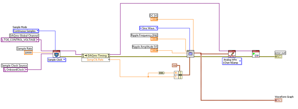

Hello Community,
I have a very simple VI which generates a signal and write it to one my Analog Outputs. I'd like to keep the signal generation going even if the VI is finished its execution, but with the current code it stops when the VI stops.
(Test case: I need to generate the DC + ripple voltage and then perform several measurements. I must use Teststand so it seems logical that I start the signal generation in step1 and then perform the measurments in step2, step3... etc. But currently it seems that once step1 is finished the signal generation finishes as well.)
Is there a way to keep the signal generation on after I have finished my VI? If yes, what would be that. If not what would be the proper approach to handle this problem?
Thanks.

Probably I was not that clear, so let me rephrase the problem:
  1. The signal generation works fine and if I put a breakpoint after the start task VI then I will see the desired signal on my scope
  2. I can't put a while loop or a stop button to this VI. My plan - and I have no idea if this is possible at all -  was that I set up the right signal on the output and then finish this VI and go to the next step in teststand which actually performs a certain operation. Then go to the 3rd one etc until I'm done.
So my real problem is that the signal generation finishes once this VI is completed and my question is if I can write a code which sets my PXI AO channel to keep generating the signal even if the VI is done. (My PXI environment is non RT)
thx.

Yes, I am aware of the parallelism in LabVIEW. But as I have my test steps in teststand already, it does make sense to reuse them instead of compile them into one VI. So thanks for your thoughts, I certainly appreciate them, but the question remains the same: is it possible to keep the signal generation going after my VI above finished?

With the code as written, I think the answer's NO.  Much like what would happen if you ran the code in the LV development environment or as an executable.  The vi stops executing and once it leaves the run state, the LV runtime engine will start freeing up the resources the vi used, including DAQmx task resources.
You'll need some version of what Bob_Schor recommended.   Some way to launch free-running code that keeps the AO generation vi in run state, and some further way to signal to that free-running code when it's time to quit.
