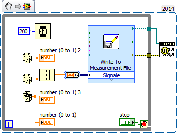

I would like to store acquired data in a TDMS file. The complete DAQ is running through a sequence within a while loop. At the end of the sequence I now included another frame where I would like to save the acquired data. Timing information is not relevant.
When I build an array from local variables and connect it to the "Signals" of the ExpressVI I get a nice TDMS file with values at each iteration. Is there a possibility to get the signal name in the header? For now it says "Untitled".
Also my TDMS has like seven sheets although I only created an array with three variables.

- I didn't change much, just the format setting to TDMS instead LVM
Well, using simple TDMS functions you can set any signal property you like!
Using waveforms with their special attributes (as explained in the LabVIEW help) will result in proper signal names in the TDMS file too…
That's because you set to include a "header per segment". Don't do this if you don't like the result!
As said before: using simple TDMS functions gives you much more control on the file layout!

Here's a quick example that doesn't use the Express VI, but the actual TDMS API VIs.
You can change the group name as it is just an input to the TDMS Write.
