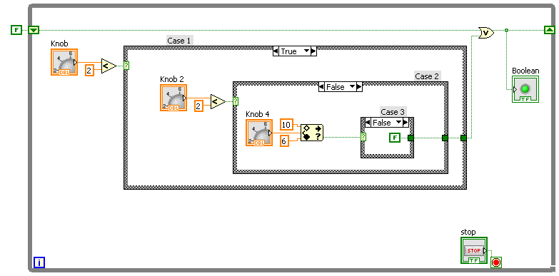

I made a program with knobs and case structures that have to turn on a led when certain limits are reached. I've done that part very well, the problem is that i want the led stay on when I set the knob to its original position. I know that I can use a flag, I tried to make it with a feed back node but it didn't work. I attached the VI. Any help would be appreciated.
I cannot find a feedback node in your attachment.
Your innermost case structure containing the TRUE diagram constant can be replaced by a plain wire.

use shift register with OR logic

apok,
Are you trying to get featured in the Rube-Goldberg thread?  Look at "Case 3"  Why do you need two boolean constants T in the True case F in the false case?  The wire out of in-range and coerce would work just as well wouldn't it?Smiley Surprised

@JÞB wrote:
apok,
i just used his code, i did not bother with cleaning/efficiencying (well i did in a sort of way by pressing 'clean up diagram) it up,please dont put me in the RG code jail Smiley Embarassed i ran out of passes? anyone up for a game of 'mouse trap'?
ouch!, i see it now... Smiley Sad

Accepted by topic author danypag
That's why I said "Your innermost case structure containing the TRUE diagram constant can be replaced by a plain wire." 😄
controls belong on the toplevel diagrams, not inside cases.
A UI loop needs a small wait
Knob 4 seems irrelevant.
Here's one possibility...

Thanx, but now i have the problem of turning it off, that is why i had a fourth knob.
Message 7 of 12
(5,086 Views)
You don't need another knob.  What you need is a reset button.  Make the button a Latch When Released mechanical action (default for actual buttons).  Invert the state of the button and AND that with the flag.  That will reset your flag.
