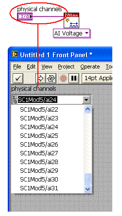

Setting up UI's for channel selection is a breeze in DAQmx when you create channels on the block diagram. The control you create off the Channels input will populate itself with the inputs that it knows are capable of performing the desired task...
ch.GIF<<< My configuration knows that my Module 5 is capable of doing Analog Input.
So... Just create a panel that waits for the user to select the proper channel. I also run a quick check of the user's selection before creating / starting the task. For example, if they choose ai30 or higher, and I know that the system isn't wired for those inputs, I'll not allow that selection. Also check for using two of the same input, etc.

Yeah, I've looked at doing things that way, but I don't really like the way it populates the dropdown list as the text is rather cryptic and generic.  Certainly you have the feature where you only get certain channels and channels that will work, and that is great....I just want something that is more custom and easier to understand.
