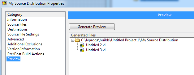

When i create a source distribution.. no matter what settings I try, the preview is always like this:
But I want the folder structure from the build to become as the virtual folder structure. is there any way of doing this without moving them by hand in the file explorer tab?

could you please provide an example of this, I only see three options, "Destination directory", "same as caller" and "Support directory".

When you go to Destination you can see " + " and " - " symbol at the bottom of the list box, you can use it to add folders. Then go to the Soource File setting and do the addition settings.
(3,033 Views)
Thanks, it is not automatic, but really saves my ass in organizing the files on disk. I did not see that button before.
