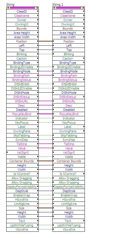

How to make the property the same between two controls?
Is it possible to assign all the property nodes of one control to the other?
Message 1 of 20
(3,680 Views)
It is possible ... provided that the controls are the same type you can simply link all properties from one control to the other, apart from the read only properties. The image shows all string properties with the 'linkable' ones connected. Certainly not very elegant though ! Do you really need to copy all properties ?

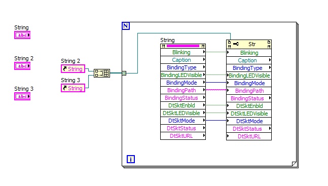

Use references to however many strings you wish to copy to, combine them into an array and then pass that into a for loop.
