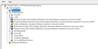

But I cannot make the example work, the Diode, strain gauge and other clases are missing from the Demo project.
Can anyone help me find those files? Tanks in advance.
