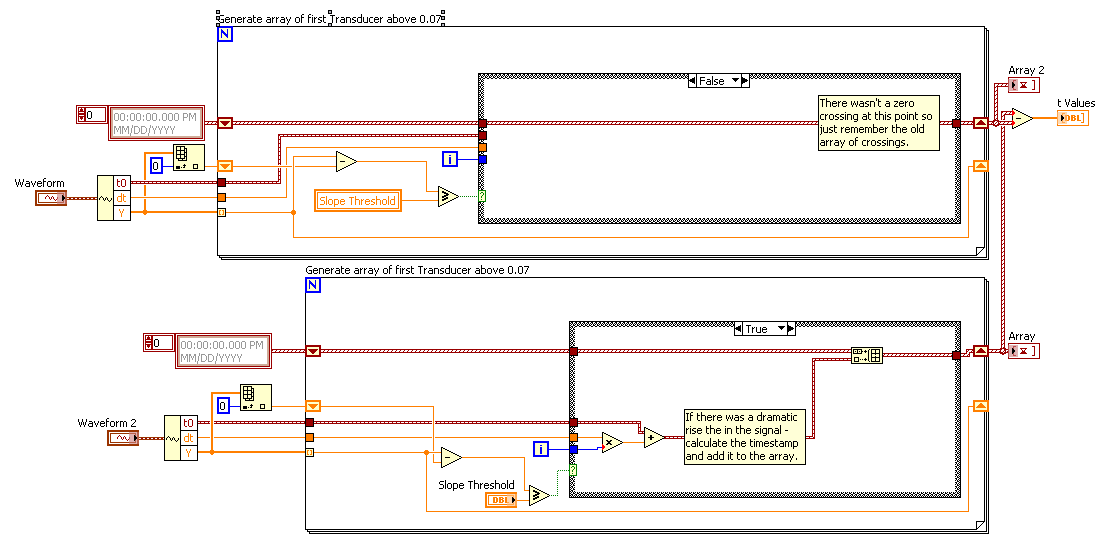

How to measure time difference between zero crossing of a sine wave and rise time of a pulse on a same graph?
You are correct that the slope is the difference between the elements.  Running the code in highlight execution might help illustrate the data flow. The reference is actually supposed to be a local variable but is converted with the snippet.  See the screenshot below for the local variable correction.
