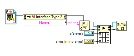

I have created an event structure to call different subVI's to do different tasks. Picture 1. When I select for example headgates, it brings up a new window with the front panel of the headgates subvi. What I want to do is push variables from my main VI to the headgates subVI. I have wired subvi's before using wires and connecting arrays, but the method I used from a tutorial online does not explain how to push variables such as arrays from the main VI to the sub. I have tried local and global variables ,but my I don't know what I am doing with them and the labview help online is all but useless in explaining in simple terms how to use each object.
Thank you.

That doesn't help when dynamically starting a VI, as OP tries to do.

Local variables are local to each subVI, but global variables should work just fine. What did you try? Did you see the help?
In lieu of global variables, you could also do an action engine if you need more intelligence/modes.
Do you need to set these values only at the subVI call or also once the subVI is running? You could launch the subVI using "Start Asynchronous Call" and wire some inputs. For later, use the global or action engine.
Another option would be the use of queues.
Also make sure to keep the terminology clear. You are pushing values, not variables (even though the values are variable :D).
As you can see, there is a large variety of solutions, but we cannot really tell what's best unless we have more information. Of course we could provide more specific help if you would attach the actual VIs, and not just truncated, incomplete pictures. (There are quite a few questionable code constructs visible.)
