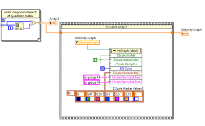

My only issue now is to change the colours map to the ratios table [0..1] which is called array 2 in the VI and not the table of occurences called array. I think it is a setting related to z scale marker value..
ok...  delete the old intensity graph, drop a new one on the frontpanel, rightclick>create> reference,
wire the reference to a property node and run the .vi
setting up the intensity graph via property node like above, the Z Scale.Marker Values[] work like an lower bound
e.g. ratio table element [0,18] is rendered blue because
 0,5 > { ratio table element [0,18] = 0,204082 } >= 0,1
