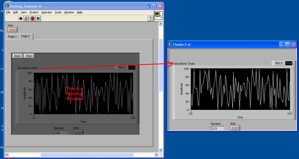

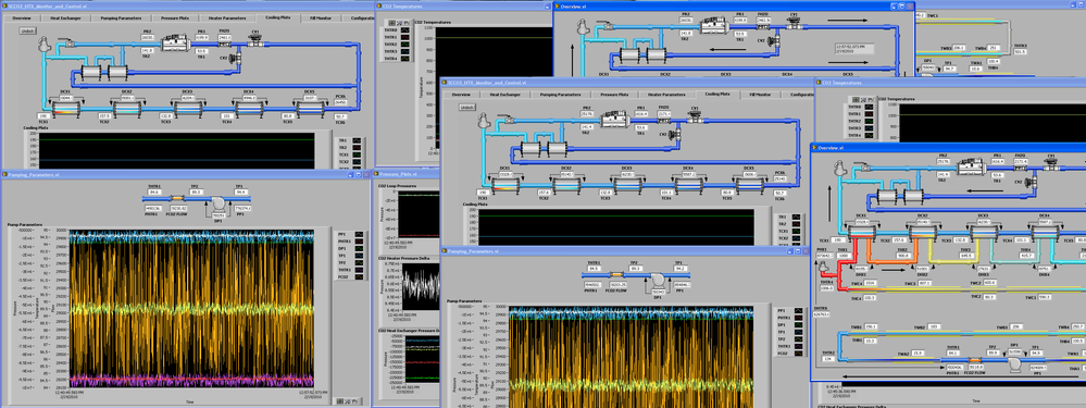

I posted a zip of code to do what I call "Docking" in this thread.
I discussed using that technique in this paper
The following sequence of images shows the results....
More images in this Album.
