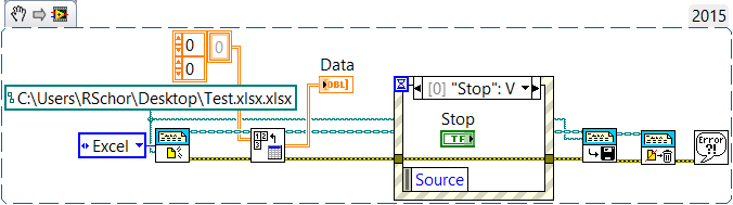

I will be happy to clarify.  I just created a simple Excel file, Test.xlsx, with the numbers 1, 2, 3 in Column A, and nothing else.  Here is the code ...
Notice the Event loop with a Stop button -- this just delays the Save Report and Dispose Report.  When I run this, Excel opens, I can see that my Excel file has 1, 2, 3, and the data being read into the array Data also has 1, 2, 3.  I can run this multiple times, and it works.
So now I demonstrate what I was saying -- I run the same program, it pauses with Excel open waiting for me to push the Stop button.  Instead, I close Excel by clicking the X in the upper right hand corner.  I then push Stop, which tries to Save Report, but it fails (some obscure Error message).  OK, so what?  Well, now my Excel file, which I've read multiple times, is missing -- it has been deleted (deleted!).  That is the problem I was describing, which I fixed by creating a function that refused to call the Save Report if (as was the case here) Excel is not running (because the Stupid User had manually closed Excel, causing LabVIEW to "punish" this bad behavior by deleting the Excel .xlsx file).
Hope this clarifies things for you.  Bottom line -- if LabVIEW is using the RGT or otherwise "using" Excel to open Excel files, then LabVIEW, not the User, must be the one to also close Excel.  Warn your users (or, better yet, open Excel minimized so the User never "sees" the Workbook).
Bob Schor
