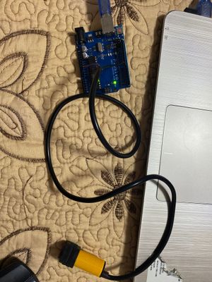

Hello!
Well i didn’t knew that i need also a resistor…
My connection looks like this, and this is my program
You say that instead i should move to Analog the black wire and do this also in program? There is a chance of doing the program without the resistor?
Message 4 of 9
(2,202 Views)
so this is the code in lab view and all i did on the arduino board was to connect the brown wire to 5V, the blue to GND and the black one to Digital 7 . And i tried to upload the code  but nothing happened...

Hi Bianca,
You still don't provide a lot of information…
This information is nonsense! How should we know what the colors actually mean?
Which sensor do you use? Mind to share specs/part numbers?
better picture of the code
You didn't attach "your program", but you attached "an image of the block diagram of your VI": we cannot edit/debug/run images in LabVIEW!
(You also don't care about using AutoCleanup…)
Btw. do you know you can edit your message (within a short period of time) instead of posting 4 messages in a row?

What's worse than a picture of code, is a picture of a screen with the code...
I have no experience with LINX, but by quick reading the documentation here are some possible solutions:
- Digital Read function requires you to Set Digital Pin Mode first (according to this)
- Did you load the LINX Firmware to the Arduino?
- As santo_13 pointed out, make sure that you have the sensor connected correctly (and that the sensor actually works)
- Are you sure you need digital read for this? This kind of sensors usually output analog values, so the better choice would be Analog Read function (and connect it to the appropriate pins on Arduino)
