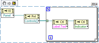

First you get the reference to the front panel of the VI, then you get the Controls[] property:

The credit goes to Sam, I just showed the property nodes that he described!
